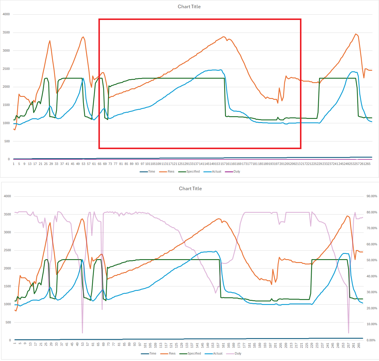

Had some issues lately, found the van to be getting pretty gutless under 3k and only returning about 35mpg.
Opened VCDS to log the boost
Red square is a 4th gear pull. Shows that there is pretty much zero boost control and it's only making boost with revs which explains why it feels like it does.
Tested vac lines and found that the little check valve wasn't working properly and was flowing both ways, so replaced that. Didn't make much difference at all.
I had put a new N75 on due to the previous boost issues, so had discounted that but I put the ond one back on, and surprise surprise, I had boost again albeit on and off.
New N75 ordered and fitted and that's it sorted
