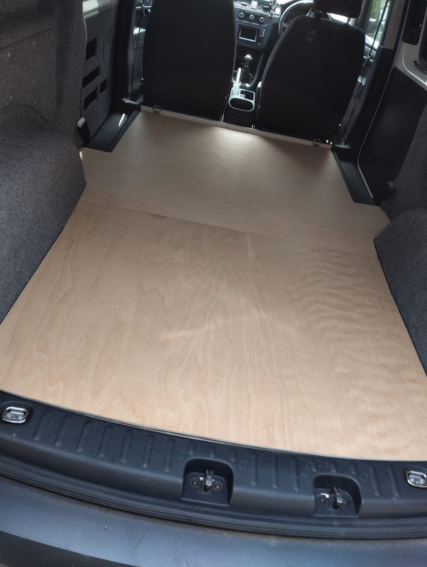

In case anyone is wondering you can get a 8' x 4' sheet in a Maxi. Just drive carefully with the sheet next to your head as you drive.
Card template on the sheet of ply. You can get the whole floor on one sheet if you are happy with the ply in two parts
The time taken doing the card template was worth it. Floor fitted first time.
I went with 9mm ply. I am aiming to keep the build weight to a reasonable level and 9mm as it turns out seems right with the amount of ridges in the floor and size of van. I'm also cutting the latch points out as they will be used to hold the furniture to the floor.

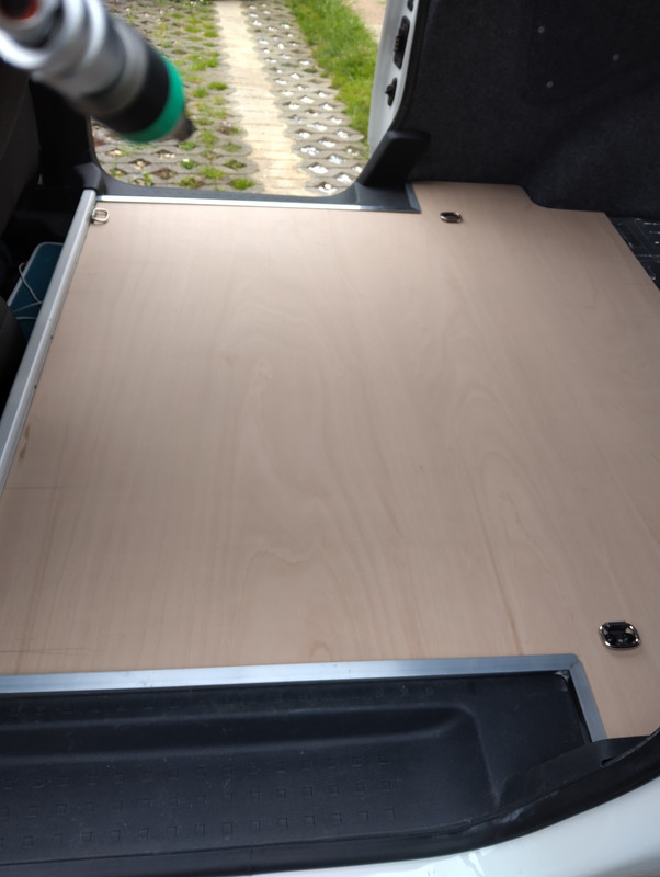

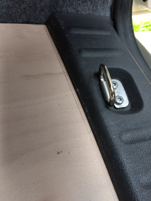

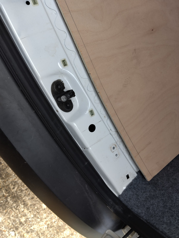

I have come to the conclusion that to get anything to the way I want it I will have to do things twice.
Was not happy with how the floor finished at the boot threshold and wanted to hide the vinyl floor under it when that is laid. Also wanted the lashing points to be above the flooring and use them to hold the floor down. The reasons will be apparent when the furniture is in.

Bought some 20mm aluminium right angle from Screwfix for £11 for 2x 1 MTR lengths. Need to screw down once the vinyl is fitted. Really pleased with how it finishes this part if the floor.
